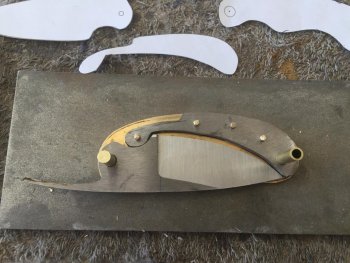

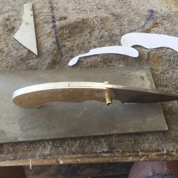

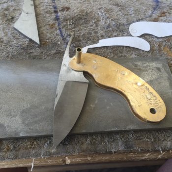

WIP This is my second Friction Folder after the one above. I designed the knife on my simple CAD program and cut out the pieces (Blade, Spacer and Liner). The blade and spacer are cut from CMP-154, The spacers are cut from 16 gauge brass sheet. Blade has been rough ground and is ready to heat treat. In these two photos the liners are glued together and the spacer has been hand shaped with the blade in place to assure fit and stop. The spacer was then glued on top of them and the small pin holes have been drilled. At this stage the liners are ready to be peened together with the spacer.
Here the liners have been peened together
Here the blade has been fitted back into place and the liners and spacer and blade flange have been trued up on the grinder.
At this stage the knife is ready for the scales to be shaped and glued and pinned in place. More to come. . . . .
