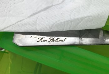

OK, I got the new developer Sat and got a chance to play with it some Sunday and today. New developer works! Dissolves the emulsion just as it should. I find a short exposure of around 30 seconds with the 100 watt flood light type bulb I am using. I may go to a standard 100 watt light bulb for longer exposure - not sure yet. That will take more testing. The font used MUCH make a VERY dark image - not allow ANY light thru. The amount of exposure will slightly darken stencil material but leave a light display of image on stencil material.
I warmed the developer to around 100ºF (warm to touch), developed for about 2 minutes - I think less time will work, more testing required.
I warmed the developer to around 100ºF (warm to touch), developed for about 2 minutes - I think less time will work, more testing required. making sure to remove covering on BOTH sides of stencil material. Using scotch tape to remove thin covering helps. Developing will quickly remove the emulsion from both sides of stencil material. Rinse good, dry, and the quick test gave results below. Still need a bit more work, but think it's going to be ok.
Ken H>
Edit: Oops, I just realized I didn't give anything for scale on the text. The text is 1" long, with about 1/8" letters. The zoomed in close up makes it look larger than it really is.
