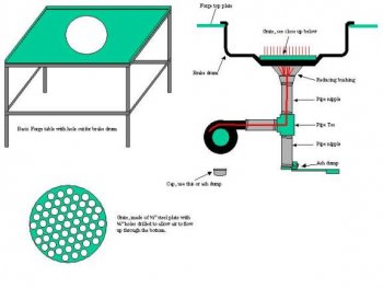

Don't use the bucket, use a brake drum from a pickup truck. Make a table about 2.5' square and recess the brake drum in the center. Pipe air up through the bottom. As you forge you rake fresh coal around the fire. I used a small squirrel cage blower and had a switch to turn it on and off. Turn it on when there is steel in there and off when you take the steel out and your coal will last longer. No refractory needed, I used one like this for over 10 years.
