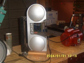

I've had mine for 2 - 3 years now. Definitely worth the price for starting out and it doesn't take up too much space. Here's a pic of how I mounted it to my bench.
Looks good. How do you mount the table to it? I'm not sure I want to drill any holes in it.
The bottom of the saw is simply chocked in by a couple of wood blocks that are screwed down to the bench. I have to remove them to take the cover off when changing the blade or cleaning it out.
The metal brace is attached by way of a couple of bolts that screw into existing screw holes. If I get a chance I'll take a couple of other shots from different angles and post them for you.
I also had one of the kids at school weld a small table onto the guide.

I just don't want to modify it, since I purchased the 2 year warranty. I plan on taking it back right before the warranty expires and getting a new one, so I'm looking for bolt on options.
That would be one advantage of mounting it as I have. It is only bolted in existing holes. Unbolt it and replace the original screws and you can use it as a portable or carry it back to HF.
