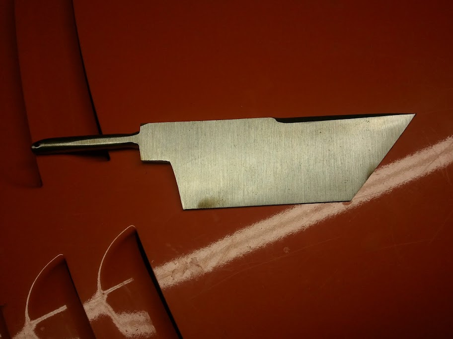

I did a full flat grind on the knife below in a couple of hours. Mainly going really light toward the end, so its got plenty of umph as long as you are being reasonable about what you need it to do. And for $160, its hard to argue with it.
If you want nice straight grind lines (and who doesn't) then James is right, a new platen should be very high on your list.
5160... 1.75" wide 5" long

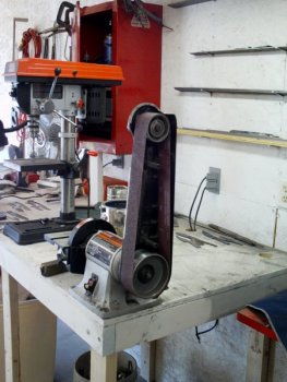

This pic shows how I removed the guards for quick belt changes and to allow access to the upper idler... it works OK as a contact wheel.
