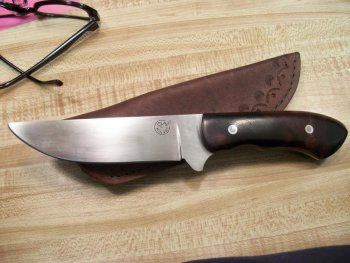

here's one thats real close to your last one this was made with a 1x30 belt grinder and files.
I used file guide to get plunge lines started at 45 degree till i met my center lines, then went to draw filing till i was tired of it then went to the 1x30. hand sanded to 400 grit. you deffenitly going in the right deriction keep at it there looking really good. :)
