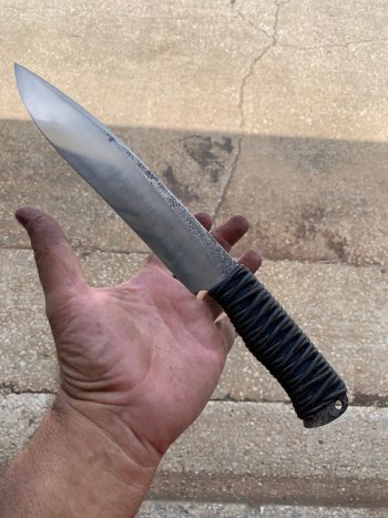

I’m thinking of doing a jimmy fikes inspired piece. The only other time I tried this I discovered that you need to have the thing a little narrower top to bottom to compensate for the diameter of the para cord. The other thing I’m wondering is how do you fat enough to handle a little bit? I know some people use leather or some kind of composite underneath hemp wrap. Is anyone used anything like that under Paracord? I’m particularly thinking about what you could do understripped Paracord done in a Japanese version. Wondering if you could put down some kind, a thin layer of filler and then do an under wrap of flat and an over wrap of either regular para cord or more stripped stuff? Kind of like a variation on what strider does?

I didn’t remember whether James used rubber or Terotough. And you can’t really see it in the knife in the picture because I didn’t do the epoxy thing properly. But I used stripped blue P record as the strider type underwrap. You can see in a little bit if you zoom in.
I was shown this paracord wrap. You remove the white inner cords and as you wrap it, give it a twist on each side. Maybe do a flat wrap of paracord under, then do another layer with different paracord with the guts removed with the twist as the overwrap? A little of the tang shows through, but it's easier than real tsukimaki! Paracord with guts is around 1/8" diameter, so it's good to keep that in mind with handle dimensions! This is the first knife I ever forged and I did it at a class I took with Mace Vitale :)

I've used regular leather and stingray leather underneath paracord, attached with contact cement. I also did it like Taz showed, by removing the inner cordage and actually ironing the paracord flat- that made it easier to get a crisp twist that was uniform. I also give it a thinned down coating of epoxy to lock it in place. If you intended on being able to remove the paracord for use as cordage, you'd need to come up with another approach.

On the nights that I posted, I did a flat under wrap of stripped blue para cord and then did the other wrap with just regular black. It was still fairly thin, like maybe a half inch thick? I want something may be a little bigger than that for a knife it’s going to have a 10 or 12 inch blade. The other thing I’m looking for is to illuminate that flat top and sharp corners when you transition from the edges to the flat of the tang that’s why I was may be thinking about using leather or something firmer than that, and not only rounding off the spine and around the handle a little bit, but also kind of beveling the edges of whatever you’re putting on the handle. The middle can be flat because you’re going to get some extra thickness from crossing over your exterior wrap especially if it’s un stripped Paracord. As for the termination, I have to figure that out especially if I’m gonna do something like you see you guys like Burt, foster or Shiva Ki do where they only wrap part of a wood handle in the Japanese style.

Are use west, and add colloidal silica when using it as an adhesive. That knife in the picture I just used it without the silica and it was still pretty thick. I also didn’t know that you were supposed to blot it after it’s soaked in, so you didn’t have a lot of epoxy lying on top of the wrap.
Too much acetone can effect the curing, so use as little as you need to. Or use a heat gun to get it more runny. Wrap the handle, put the epoxy onto the wrap and then heat gun it on low and it should thin out and soak in. Or soak the paracord in epoxy, heat the epoxy and then wrap, bit it will be messy!
