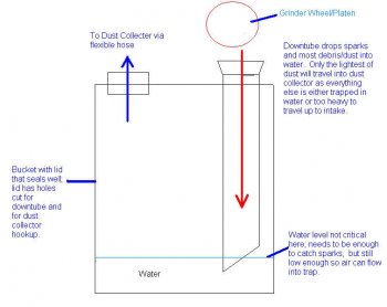

You have two concerns:
1. Spark control.
2. Containment of fine particulates.
My concerns are the same as yours- I have a basement shop and did not want to exhaust outside. (I could exhaust outside, but I did not want the wide temperature swings.)
I use a 1.5 HP collector rated at 1100 CFM. It originally came with a 2 micron cartridge filter, but I put it aside in favor of finer filtration.
On the intake side, I use a metal cyclone I bought for woodworking. This has the exhaust tube (of the cyclone) cut at a severe angle, and the bucket is filled with water to cover the bottom half of the tube opening (EXACTLY as shown by Chuck in post #7). To the best of my knowledge, this takes care of spark control.
Because I wanted to recirculate air rather than exhaust it outside, I do not use the factory cartridge. I contacted my heating/air guy and obtained a 1200 CFM HEPA furnace filter.
By definition, a true HEPA filter will trap 99.97% of particles larger than .3 microns. (Three-tenths of one micron.)
A sheet metal box was built to house this filter and connected to the exhaust side of the fan.
This setup has worked great for me. If I'm working with wood, micarta, etc., I run the cyclone dry. When I grind metal, I simply put water in the cyclone tub.
The biggest expense (aside from the collector itself) is the big HEPA filter; mine runs around $150. But it has performed well for over a year without changing it out. Even at that, the amount spent on it is well worth it for a years worth of almost daily use.
With a smaller unit such as your proposed Grizzly 500, you can get away with a smaller, less expensive filter.
If you go this route, make sure you size the filter correctly. IOW, make sure the filter will handle at least the amount of CFM for which your fan is rated. Too much backpressure could burn up the fan motor.
Good Luck,
Robert
Build one of these. I need to.
Chuck,
That is a genius set up there and one that looks like it could be adapted to a regular type shop vac, I will definitely be working on one of these very soon! I was a "Firehouse Subs back in the summer, at the time I found out they support a charity that helps Firefighters that were injured in the line of duty. One of the ways they raise money is by selling their used pickle buckets, they had 5 there with lids for 2 bucks each, I bought them all! With no intentions planned for them, this is perfect for one of them, THNAK YOU! Rex
Even better than this, there is a home make cyclone separator you can put water in the bottom of.
Others have used this setup say the downforce of the air blows the water up so it gets caught and exhausted into the shop vac
There are free plans about, if I can remember the name of it...
Thein
http://www.cgallery.com/jpthien/cy.htm
in the discussions it misses some fine dust, but in that setup it traps most of the debris before a shop vac
If you have water in that trap, I think it would work fine.
