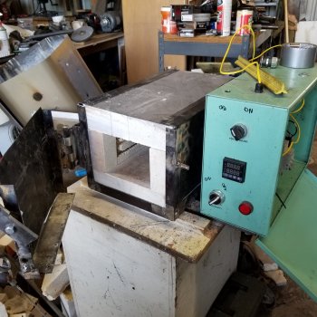

I built an oven. It took me a while to scrounge and save to make it. I have about 400 dollars into it. But for some reason it either pops my 220 breakers or the breakers in the control panel. It's not a priority right now but I'd like to get it working. I have some 440c blades to HT. This is the last picture of it. The door is actually finished now.
