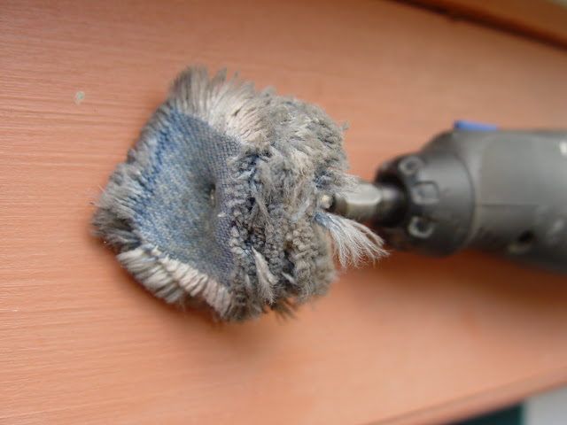

These days I use this little hand held buffer; much better control, gets into the small spaces and doesn't scare the life out of me.

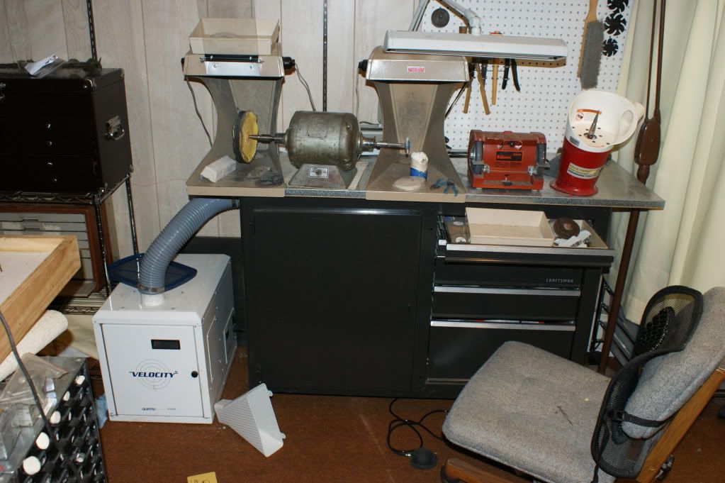

http://i1258.photobucket.com/albums/ii533/Goldsmithy/New%20shop/DSC00881_zps6d69d599.jpg
I hope the link works, it's the first pic I am trying to post.
This is my buffing set up. The little graver grinder is gone. The motor runs at 3450 rpm. The hoods and platform around the wheels are to contain thrown objects and collect dust. This is the what I used to polish jewelry when I was gold-smithing. ...Teddy
