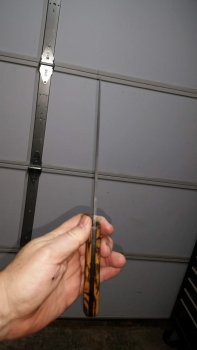

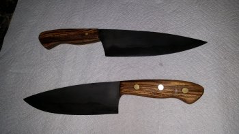

Here's a couple of pics showing the hamon and spine, after "re-etching", which I decided to do on both blades.
