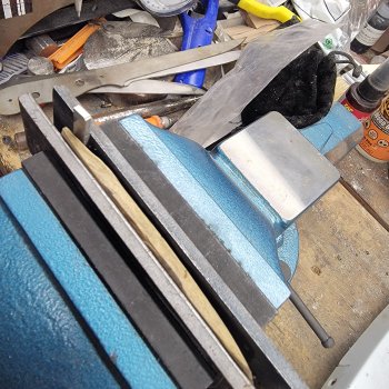

Boiled and back in the vice! Hopefully the curl that occurred after I removed it from the vice will be gone or removable with some sanding?? These are a lot of work and as I said I won't be doing them again. Does it work yes but a jigged bone would be a better choice IMO? Anyway I will follow up with finished pics when I get there!

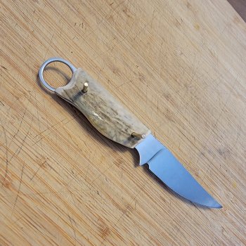

Have one side roughed in but the other side is giving me a PITA!! Boiled it again today back in the vice! Spending way to much time on these! Learned a bunch though! If I ever do this again I'll do things a bit differently for sure. I can't see me doing them in the near future though! Gonna need to stabilize and add liners.

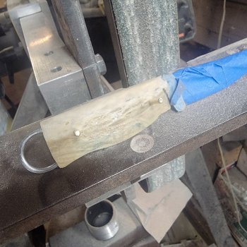

Making some progress! Much bigger challange than I expected! Antler was stabilized then Epoxied to some White liners. Rough fit right now! I'm friggin paranoid it's taken me it seems forever to get here!

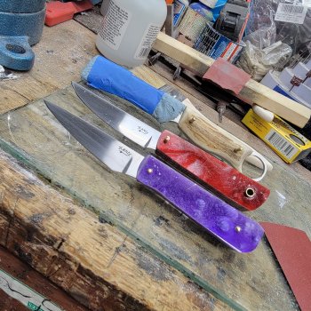

Front and back polished, need to epoxy them on now. Have to get some Mother of Pearl fret dots to cover pins (customer request). Anyway a paring knife and a Trout n Bird knife all ready for epoxy too!

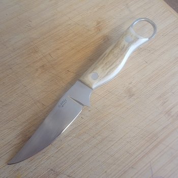

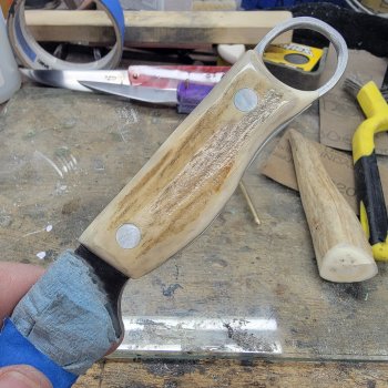

Well coming along Mother of Pearl inlays done! I epoxied these in first cut very short SS pins and epoxied those into one of the scales. The MOP went in way easier than I thought it would! I used a Brad point kinda drill bit to countersink the pieces. Very happy how they came out and would consider doing the MOP inlays on the right project again (no antler scales though!! LOL!!)
