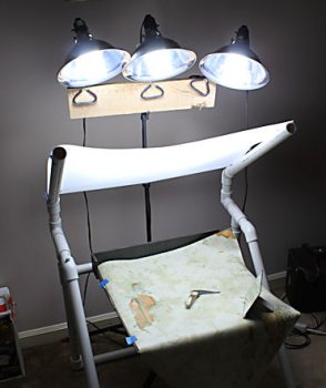

If you don't mind, do you have a pic of your photo set-up? Always interested in how other photographers do it. Thanks.

Still in the simple stages. It will be modified as I go along.
Robert

OK Robert... after seeing the photo of your setup, I have another recommendation:
Disclaimer - I am NOT an expert. My wife IS a professional photographer... not me. I just borrow her equipment. :D Take all of my advise with a grain of salt.
Enclose your light box. It's called a "box" for a reason. ;)
If you look at post #24 in THIS THREAD you can see pictures of my photo setup. You want to enclose as much of the space as possible. You'll notice the big piece of white foam-core on the floor in the first photo. When I am actually shooting, I will use that board to block off as much of the front opening as possible... leaving just enough room for an unobstructed shot from the camera lens. The white interior of the "light box" will help even out the lighting all around the knife (like those shadows that I mentioned earlier).
You'll also notice that I have two lights (both 500W halogens... which do require white balance adjustment). I used to have them both behind/above the light box. I find that shining one from the side, as shown in the pictures, actually improves my final photos. Your mileage may vary.
These are just some things to think about. Please share your results with us as you tweak your setup and technique.
