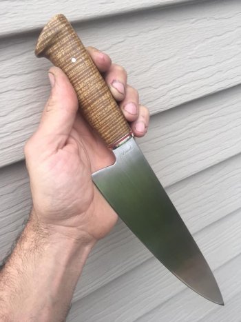

I just got a muzzleloader rifle kit and it shipped in a wooden crate, the crate itself is no good but they used curly maple blocks hot glued inside
for bracing the parts...enough for a couple nice handles!
you never know where nice wood will pop up.
