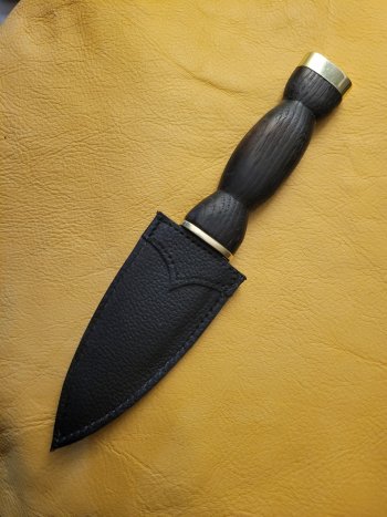

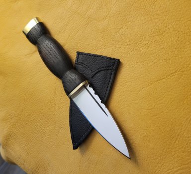

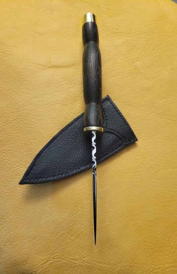

Had a request for a sgian dubh for a wedding present this past Sunday, oh and I need it by Thursday. .....let's see a knife I've never made, that has a legal size restriction on the blade if you ever take it to the Highlands or the UK, in 4 days..... why not let's do it.

opaul
These are one of my favorites to make. You did a good job on this one. Looks like you even used big oak?
FD Kingery
Thanks, It was a fun build, had to fabricate the butt cap, my first thought was to make it a stone setting but I didn't have anything shaped or polished, didn't have any bog oak so the handle is a cut off from an axe handle that I torched then steel wooled before adding 4 coats of satin wiping finish and finally a couple coats of minwax rubbed in for a nice soft feeling finish.
opaul
I’ll have to remember that!
