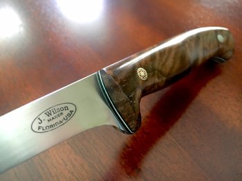

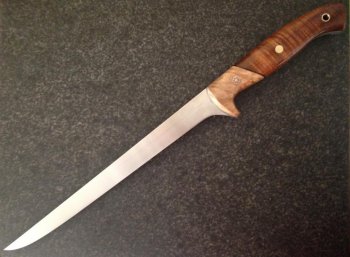

That convex edge is great on large fish where you may want to go through the ribs along the spine. For that purpose I don’t take the flat grind all the way to the spine until a bit out past the handle. Those little flats near the handle add just enough stiffness that the blade doesn’t really begin to flex much until about halfway down the blade. (using .070 steel)

John, that full length photo knife is just too pretty to bounce around filleting fish! NICE work on that handle.
Yes sir, I'd be grinning ear to ear while I was filleting with that one John!!
