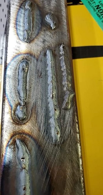

I am definitely not a good welder and was playing with it today a little bit just pulling practice beads with my Hobart Handler 140. I have the gas conversion so it's easier welding than the Flux-Core wire. Nice to have a table to attach everything down. Take a look at some UGLY practice welds! LOL!
I've not been formally trained as a welder, nor am I certified. But, I do a fair bit of welding in my shop, MIG and TIG. One of the great joys in my life has been to think up (or copy) a project and weld it together. Over the last year or two, I've made a bunch of "stuff" to support knife making. That's the thing - welding is the tool that allows you to make stuff - so you can do other stuff. Welding opens up all kinds of possibilities.
