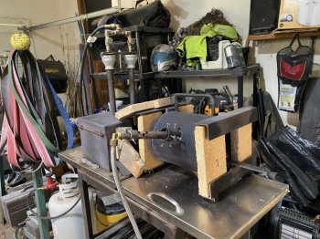

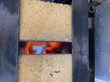

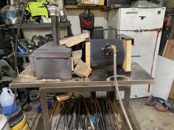

This is why I do not make swords. Nothing big enough to HT the dang things. So, introducing frakenforge...

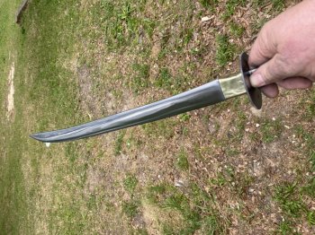

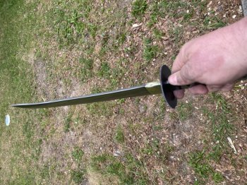

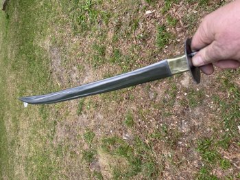

Still have a long way to go but not too many people can get here with just a chunk of leaf spring. I have to get better at this the habaki looks like its been through a car wreck. I made it from a .50 cal. Shell casing so at least that is cool.
