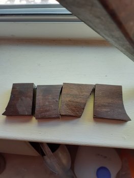

I've never tested shellac or a full coat of ca so I can't speak to those, but have read warnings of them getting cloudy with moisture. I do like tru oil and think it's similar to my tung oil in its effect on color. Here's an experiment I'm doing after cleaning as mentioned above. Left to right ironwood with tried &true (linseed beeswax),pure tung oil, spar varnish oops edit last sample plain. This is after a year and a half east facing Phoenix AZ window. I like what @Ken said.
