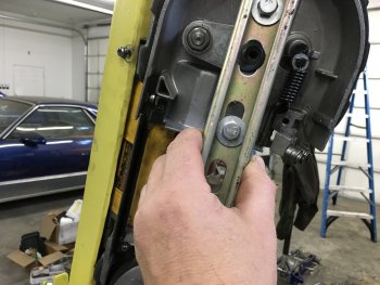

This saw is several years old but has very little time on it. From day one the blades would come off if not applying force against some metal. I found that if I bent the idler wheel bracket slightly, I could adjust the tracking. A little more adjusting should make it travel correctly, I am still getting it setup. This first adjustment took only a few minutes. I removed the bracket, put the bushing end in the vise and bolted a piece of uni-strut to the bracket to use as a pry bar. The pictures are after I made the adjustment but wanted to show where the uni-strut was bolted on.
