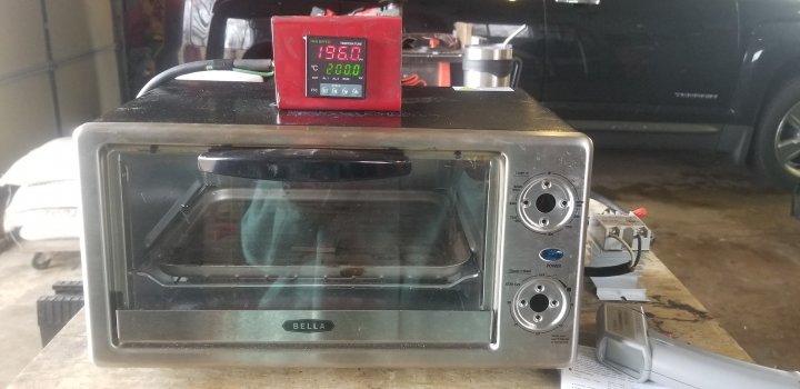

Well I voided all warranties today on the toaster oven. Well not that it had any because it was a used one that I bought. I got my temperature controller hooked up and I can now run a PID loop to hold temperature. The only thing I don't like about this controller is it displays in centigrade and not Fahrenheit so I need to do the conversion which is no big dealing. Did a test run up to 400 and held it there within 10°. I'm going to insulate the toaster oven a little bit better just to be more economical. Getting closer to completion.

Yesterday I ran across an old pizza stone I haven't used in a few years. I cut it to fit inside the toaster oven. This should help keep a more even temperature.
MTBob
Certainly give that a try. I found adding internal mass to my toaster oven didn't make that much difference. In fact it actually made things worse since it screwed up the PID settings and I had to reprogram it. So, I stopped adding bricks and stuff to add mass. I believe adding a blanket of Kawool around the oven will benefit temperature stabilization more than anything else. It's all about your PID recognizing the amount of energy going into the over in versus thermal loss, coupled with the rate of change. At least that's my experience.
