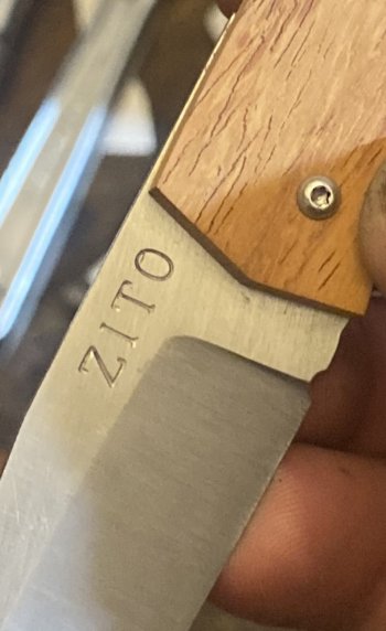

Hey, have you tried letting the belt overhang the platen or wheel just a tad…. 1/8-1/4”.? I’m not sure if plunges like this are what you’re looking for, but it’s a lot faster… no tools necessary.
that is exactly what I'm looking for. I've tried the belt overhang, but I guess my hand is not steady enough or something. I make a mess of it...
They key is VLP. Very light pressure. You have to just barely “bump” it next to the platen. I’m not sure how tight of a radius one can achieve using the jig method as above. I guess it all depends on how small of a small wheel the jig will accept.
I have freehanded my plunges for 13 years, just got the jig in July :)
I can get pretty close by hand, but the jig adds another level of precision.
Light pressure, slow speed, lower grit. I tend to cut the plunge in to final shape with a 120, then refine with a 220 and 400 and hand sand after that.
Another advantage of the jig in addition to the precise radius, you can finish that radius to 400-600 or whatever on the machine, so you don't have to fight to get those scratches out of the corner of the plunge radius when you're hand sanding.
