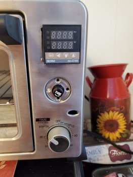

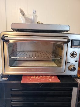

This was my solution. I insulated with 1/2" Kao Wool with rigidizer to keep wool inside oven from flaking. It is 12-1/2" w, 11-1/2" d and 8" high. I bought the oven at a tag sale for 15 bucks, PID kit was 14 or 15. I think all toll after buying some miscellaneous things I'm into this for around $60 - $65. I have about $80 total into it but this was because it was a design as I build project and I changed some things as I went. Works GREAT holds + or - 2Deg. I did because of space constraints. If I had the room I think I would have used a cheap or free Craigslist stove with PID.
