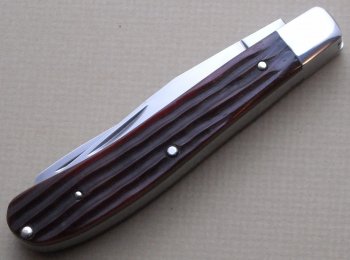

Since I am new at this myself, I have done a lot of looking and pondering on how to do things. I have seen quite a few with heads that have been spun. I think some of K.R. Johnson's have spun heads. I think there may be something on it in one of his tutorials. It looks like when using stag that is really rough, it is about the only way to do it. I just got a head spinner the other day and think I will give it a try on one. I will post later with pics and my take on how it went. Don't let the pin peening scare you off. I have only made 7 so far and I peened the pins on all of them without ruining anything or binding one up. I will say that nickel silver pins for everything but the pivot sure makes life a lot easier than all stainless pins.
I don't make folders but I use a lot of jigged bone and after I pein the pins I use a cup burr chucked up in my drill press. I find they work nuch better than head spinners. I did finish a slip-joint folder kit and did the pins that way. There's a pic on here somewhere. I'll try to dig it up later if y'all wanna see it.
