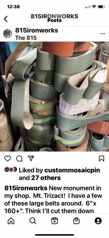

I follow this guy on IG. He has come into a large supply of cubitron and trizact belts in the 6x160 size. If you can splice belts you could potentially get 6 2x72’s out of one. He is selling them for $10 a belt. That works out to about $1.60 for each 2x72. I do not know him personally so I cannot vouch for him but I am going to order some. You can wait and I will post when I get them. I figured I would share with my friends.

Belts are easy to split to make 2" wide, but how you gonna splice them together? Before ordering many I'd take time to take an old 2X72 belt apart and splice it to see how it works.
There are several videos on youtube on how to splice them. I was kind of hoping someone on here would have a good method. That is my concern as well Ken. I think I will still order a couple to start and see what I can do. I have my own ideas about splicing them as well. The low grit belts concern me more because I run them at high speed.
