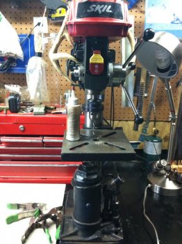

Small DP tip to add.
JawJacker
I'm used to using a stout drill press for work almost no flex. I purchased this small bench top, it does well, but way to much flex on the table. I placed a small bottle jack underneath and now its amazingly truer and relatively quick to adjust.
I saw someone using a clamp, but I think this is easier to make finer zeroing adjustments.

That's a great solution. I have a little 8" HF that I don't use. I'm going to try this.
