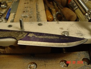

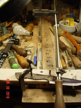

Here's my grinder. Completely home built. 1 OMP. (old man powered) 0 volts (just an occasional meal) unlimited grinding and sanding abilities (till old man gets tired) Base grinder uses Nicholson files (usually from garage sales, however always on the lookout from ebay) Sanding unit consists of exotic and very rare junkus pinus wood. sanding medium is special order from a specialty supplier of sanding medium called lowes specialty sanding medium supplier store. No wonky drive wheels or user unfriendly adjustments. Also, completely portable and all components are user replaceable.
These units are no longer available to the public (Thank goodness! )

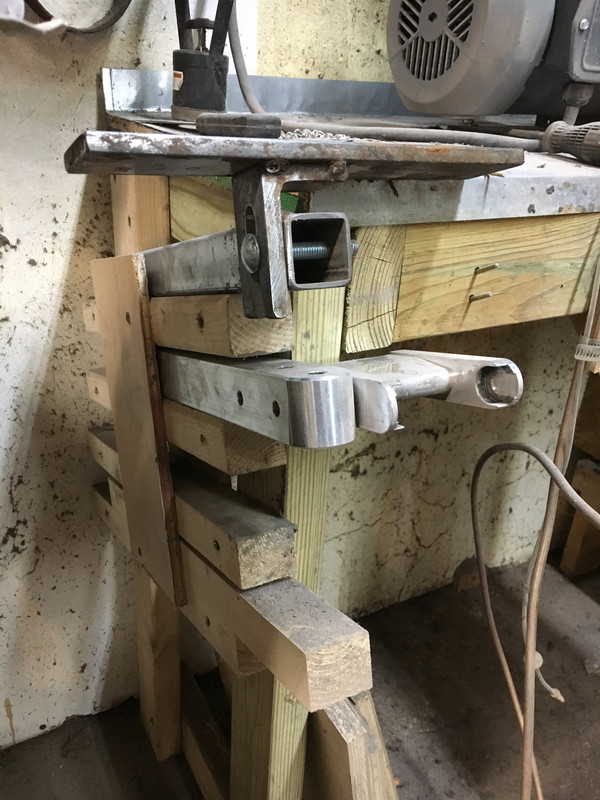

My grinder is one I built and have improved on till it is about all I could ask of it now. 2 hp 3 ph motor with VFD to run the 6 inch drive wheel for 3400sfpm.
This is with the flat platen installed and the short work rest. The other work rest is about 2 feet long, topped with 1 mill micaarta and is used exclusivey for the aluminium grinding guides.
Built a tree stand to take the too heads although the two work rests sit on a stool to the left of the grinder under the buffer and disc sander platform. Only carry 60, 120 and 220 Zirc belts and 220 450 and 600 in the trizac
