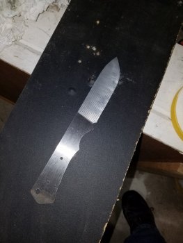

Finished my first and am working on my second. This one was inspired by Aarron Gough Resolute III, blank profiled, bevels filed in, heavy file marks sanded out with 80 grit paper, onto the 150. More pics to follow shortly! Hope the Forum members don't mind me posting my builds? I just want to show other beginners that if they have an interest in trying this hobby "JUST DO IT" (Copywright infringment?) Stop surfing and make a plunge!!

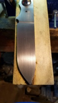

Here is the new blade sanded down to 120 Grit, 220grit up next.
Trying to post some more pics of blade but says the file is to big. is that something new with the new software?? Never had a problem before.
Ok pic resized hope it works. Here is blade sanded to 220, thinking I may try 400 for this one before heat treat?
I like the resized pics better!!

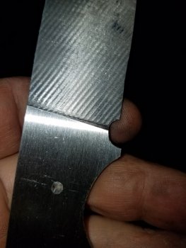

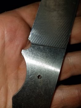

That looks nice. That is a clean plunge line, does it go to the spine?
Yeah. I wanted to merge the plunge and make it just disappear just before the spine but, I had a problem with my filing jig and to correct it I had to file one side a little deeper so it went into the spine. So I matched the other side. Next one on the jig I will measure the eyebolt and write measurements down so I can duplicate on other side. But that jig is responsible for those plunge lines! It works GREAT just a learning curve with it just like anything else. Next one will be better!!

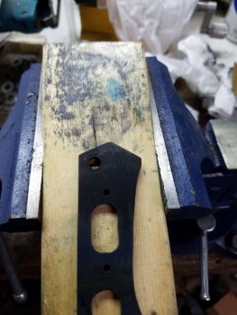

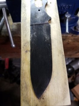

That's a nice blade. How do you plan to do your heat treat and temper?
I made a 1 brick forge that uses a propane torch, and then I do a 2 hour temper at 400 degrees in an old toaster oven. Seems to work pretty good with the 01 steel?
Just did the Harding, need to temper next.
Did you do the file test on the blade to check the hardness?
Yes I did skated right off like it's suppose to! Heat treated the back end of the knife also, that is going to be pointed up to use as a window break.
