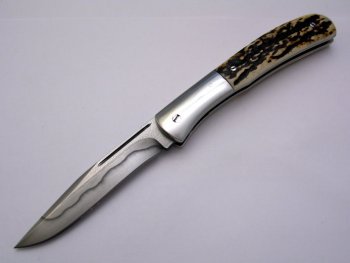

I build slip-joints that are completely screwed together. I can take them apart and put them back together as many times as I want. The other advantage I have over makers who pin knives together is that I can adjust the spring after the knife is completed. On more than one occasion I have sent knives to clients who didn't have long or strong fingernails and the spring was too strong for them to open the knife easily. They sent the knife back and I took the knife apart, removed some of the spring material and lightened up the spring action. Screwed the knife back together and put it back in the mail.
To adjust the spring on a pinned together knife you would have to carefully grind down all the pins including the pivot and knock them out. Then remove some spring material, and adjust the spring. Then you would have to pin the knife back together, re-finish the bolsters, and the possibly the scales. It would require you to finish the knife twice. That's a lot of work, and time.
I'll stick with screws,
Chuck

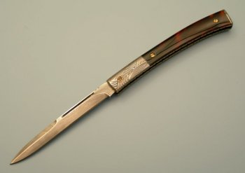

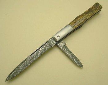

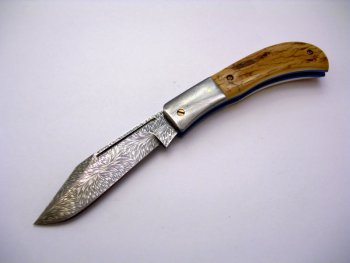

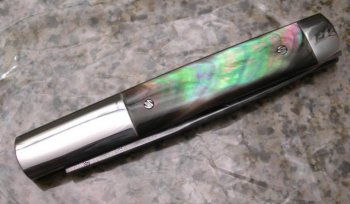

When I started using screws on slip-joints I received some flack for doing so. So I built one with no screws showing except for the scale screws. This knife is completely screw together construction, I just hid all the bolster screws.
Chuck
# 3 and #4 are real nice i like #3 best yes my kinda knife, screws all the way. i've never made a pocket knife yet well 1 1/2 first one was a little sloppy sec. one havent finished yet. i want to make a slip joint so bad just can't get my head around it yet ,just afraid I guess, 176 knives under my belt butttttt,not that slip joint yet. dang it !!!!!!. nice work. Chuck
Clint
