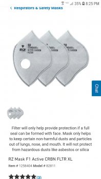

Anyone tried one of these?? I just ordered one to try out. Figured it would fit good under my full face shield. The other respirators I have dont fit very good. If this doesn't work I think I'm gonna get a face-shield/respirator combo.
springer82
I just looked at them. I have never used one. I don't know??? There's not much for filters from what I see. If you are looking for a full face shield I'd do the good one. You dont want to be breathing in that stuff.
Gliden07
I went back and looked at the replacement filters. Unless you can find one that is good for silica I'd pass on that one.
Maybe someone can correct me but I believe Silica is an Organic compound. According to my web search Active Carbon Filters are good for Organic compounds. To be safe though I sent them an Email.

Went on the RZ site looked at their filter offerings, there is a link on each of the filters to a report on the testing they did on their filters. The report clearly states they are not for use with Silica. I did ask them in my Email if they had plans to make Filters for Silica also. So we shall see. Also for anyone interested the rating for a filter rated for Silca seems to be N95 this is the recommended minimum there is also an R95 and P95. I am going to do some more research though I am probably going to end up getting a full face respirator/mask or a forced air system?

Ok here is the reply from RZ.
Stephen,
Thank you for reaching out. We are very excited to currently be in the final testing phase for NIOSH approval. Until this is completed, we are unable to recommend our masks for use with silica. When working with silica, OSHA recommends using an N95 or greater mask. Testing for these ratings has many stages and is where we have received our published filter test results. So far in the process, our filters have been tested to block 99.9% of particulates down to .1 micron. An N95 or N99 rating means that a mask filters at least 95% or 99% of particulates down to .3 micron. However, because we are still in the testing phase, we have not yet received a rating.
If there is anything else you need, please let us know. Thank you!
