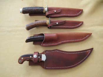

I think the issue of the stitches picking up the dye color is a result of the type thread used. When I hand stitch, I use waxed artificial sinew (advertised as "natural" color), I believe that due to the wax, it doesn't pick up any of the dye color (and least it never has for me). Now that I'm machine sewing, I had to find a thread for the machine, that doesn't pick up dye color. That is bonded nylon in "natural" color. (DO NOT BUY/USE the cheap imported sinew....it's a nightmare to work with)
It looks to me like you're hand stitching?
And it appears to be a nylon thread you're using?
When I hand stitch, I use a overstitch tool (some call it a "star wheel"......a #5, which means 5 stitches per inch). I use this tool to mark my stitch line on the sheath, then I go to the drill press, and drill each an every hole with a bit that is slightly small than the needle I use. In my case, that's a #53 bit. Once all the holes are drilled, I then V-gouge the line of holes so the stitching lays below the surface, sew/stitch the sheath (saddle stitch....a longer piece of thread than I neee, and a needle on each end), then the steps I mentioned earlier.
Why say all that? To lead into this..... After everything else on a sheath (hand sewn) is done, I take that Overstitch (star wheel) tool, and go over the stitches with it.... with the waxed artificial sinew...... it makes the stitches nice and flat (kinda looks like a ribbon), and highlights them.

I think if you were to start marking with an overstitch tool, and drilling rather than punching the stitch holes, you will see a night/day difference in the appearance of your sheaths/stitching..... especially is you give the waxed artificial sinew a try, and also use the overstitch tool on the stitching after it's in place.
Judging from the pic of your sheaths, I'd guess you're doing 3 or 4 stitches per inch? If you used a #5 overstich tool to mark, and do the 5 stitches per inch, that will give your sheaths a more refined look too. With more stitches per inch (to a point), you will have less "pucker" along the edges, because the extra stitches "pull" more evenly on the leather.

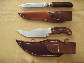

Well I seem to have a different way of making a scheath, make a paper pattern cut out the leather sew on the belt loop, then wet form it to the knife let it dry, make a welt to fit the blade, used to use contact cement but have gon to double stick tape it does not plug up my core drill that I use on the holes, I finish the edge on the grinder to 400 grit, put a stich line on the out side only, after the holes are drilled , sink the thread line on the back side with a air turbin with a ball bit,use two needles with waxed thread to sew it, redo the edge with 400 grit. Wet the edges and work harden them with a spoon or something smooth this lays the roughness downlet dry, I use only olive oil or obenaufs leather conditioner, pour the olive oil inside roll it around and pore it out, put it on the out side with your hand or a rag, put it on untel it is as dark as you want it, it will have light and dark places but they will even out. A good saddle maker told me never seal leather if you want it to last it needs to breath and take on oil. After all is done take a felt bob in the foredom and burnish the edges with some shoe polish. And like has been said by others buy the best of every thing.And I do use a star wheel. There are many variations that can be done, and may things can happen to the process . The sheaths in the picture are done in this manner, the bottom one in the top picture is done in obenaufs the others in olive oil.
