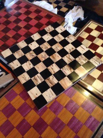

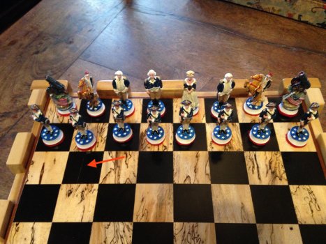

I've used Titebond (original type) on my chess boards. There's some debate over which type of Titebond etc. but I've had no issues with Type 1 over the years. I've used horse hide glue before and it's notorious for floating and slipping - and it does that without fail. So I don't use it for chess boards. I've used 1/4 inch thick Gaboon Ebony (kiln dried and kept dry for 3 years in my garage) on two boards and yet a couple of the squares still cracked - on both boards..I tell myself it adds character - which is BS...I want perfection. I wanted to keep the boards thin and light but my experience has been with anything less than 3/4 thick wood is going to warp. Maybe because I tend to over clamp and go too thin to save on board weight. I've made 10 boards - most are about seven years old now and used fairly regularly. Used all sorts of different woods Pink Ivory, Gaboon Ebony, Purple Heart, Chakte Viga, Black Walnut, Wenge, Bloodwood, Spalted and Birds Eye Maple etc. I haven't heard or seen any issues with separation from using dissimilar wood types - I'm not saying it isn't or can't be an issue, just I haven't experienced it. Warping with thin woods has been my biggest issue. You can see the crack it in this photo of Gaboon Ebony and Spalted Maple.
