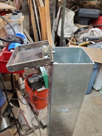

Nice, I like the valve idea! I built one for longer builds out of a Galvinized post railing. This is the only picture I found. Built lid from 1/8" plate, plugged the screw holes with weld. Plan on filling with some Muratic Acid to get rid of galvanizing inside but want to keep it on outside. Welded so.e handles to it also to make it easier to pick up.
