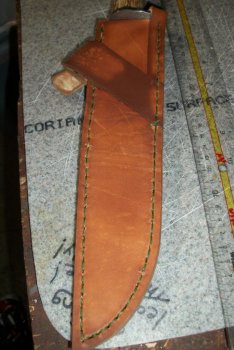

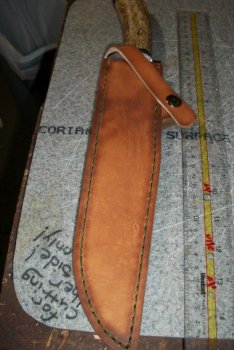

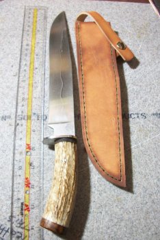

Well guys just to show I do take head what I hear. This is a sheath I just did for a bowie I made don't now if I have showed the bowie
but think the sheath went well. Still need to work on the back side a little more but hey baby steps :) Still need to clean the leather burs on back and
decide how to cut end of strap so still needs a little work.

Hey guys just checking in. And to ask how you guys like where I put the snap on the sheath above? Akey did scott send address?

Franklin , I like where you put the snap on the sheath , it is where it will not rub on the blade .
franklin
thanks Art that is what I was trying to get away from. And thanks to you and marvin, This knife is the one I did my first bolsters on not just those file ones.
