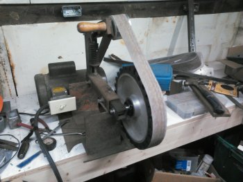

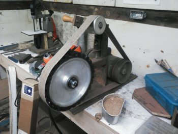

Ok so today I ordered a 4" tracking wheel and a 6" drive wheel, I ordered my VFD and motor which by the way are on sale and were $50 cheaper than they were last week. I also ordered my Sunray 1.5x2 and 3x2 wheels for my platen. I'm going to get my metal to build my grinder with soon. Cant wait to start fabricating this thing the last grinder I made was back in 2000. I attached pictures of it below.

That looks like a good combo - $200 is about right price for the 1800 rpm 2 hp motor and $77 for the NEMA 1 enclosure VFD is about right. Looks good.
