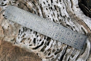

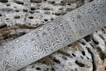

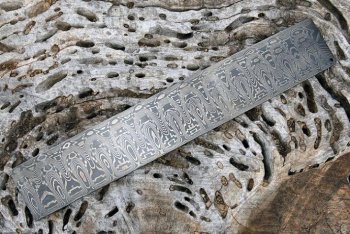

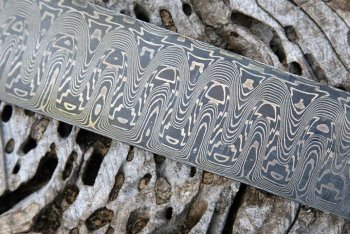

Tsunami pattern billets.
Ernie, Thanks bro..
Heres the pics I promised. These are surface ground and are dead flat.
This grinder is going to really improve alot of aspects of my knife making.. as well as make the billets we sell even better for you guys!
Again Thanks Dogs for all the help and advice!
