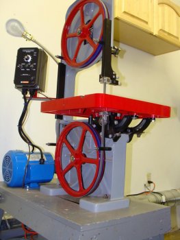

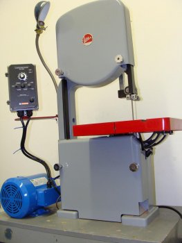

Here is one of my recent rehab projects for my new knife shop. It is a 1950 Atlas 12" bandsaw I found it on Craigslist for a price I couldn't refuse. I totally disassembled the saw and started media blasting all the parts, I then used an epoxy primer and then a modified acrylic enamel for the paint. I installed all new bearings and even went with the new urethane tires. They seem to be working very well. I also decided to go with a 1hp motor and a vfd for this project I can turn the bandsaw down to run 25 FPM all the way up to 2000 FPM and it is whisper quite. I want to thank Wayne Coe for all of his help on getting the motor and the VFD and answering all my questions.
Thanks for looking
Mike
