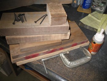

Parts list:
two 2x4s cut 9" long
one 2x4 cut 2" long
two Ix6s cut 13" long ( this would be stronger if you used 3/4" plywood)
one 1"x 6" cut 10" long
one 1x6 cut 4" long
two drywall screws 2 1/2" long
four drywall screws 1 1/2" long
Gorilla glue
This is all you need

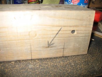

First I carefully glue and screw the two 9" 2x4s together. This will act as your main leg and has to be flush so the press sits level. Then I put a 2 1/2" notch in the 2x4s. I measure 2" from one end mark it and measure 2 1/2" again and mark it and then make the notch 3/4" deep.

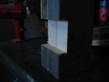

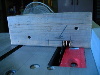

I used my table saw to cut the notch. Set the blade to cut 3/4" deep and set the fence on the saw at 2" to start with. I moved the fence a saw blade thickness several passes until I came to the 2 1/2" mark. this gave me the notch I needed.

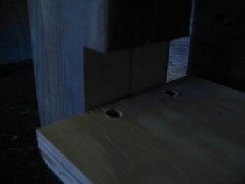

Next I glued and screwed the 2" 2x4 about 3" from the end of one of the 1x6s. Then I glued and screwed the other end to the bottom of the notch.

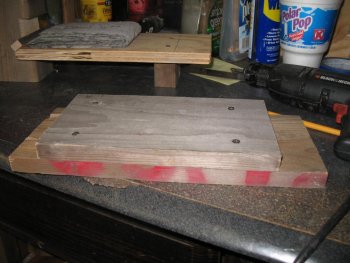

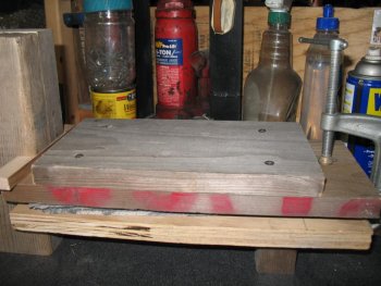

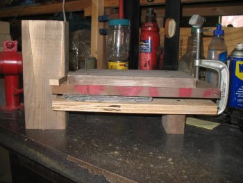

Now that the base is finished I took the remaining 1x6x13" board ( top plate )measured 1 1/4 from one end and glued and screwed the 1x6x10" board to it. , setting the 10" board to the 1 1/4 line. This end will set in the notch. This notch serves as your third hand. Under pressure this notch keeps everything fairly steady so you can get the clamp in place.
Let the glue set and then grab a c-clamp and make some micarta.

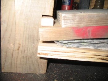

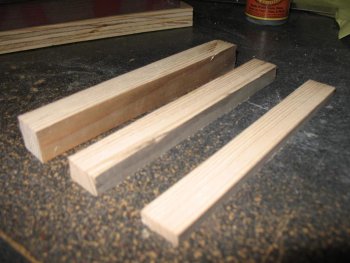

Oops! I forgot something. You can make different thicknesses of micarta by using shims of different thicknesses. That's what the 4" 1x6 is for. I took this piece and ripped three pieces from it, one pc 1/4" thick, one pc 1/2 thick and one pc 3/4 thick. If I remember my measurements right no shim will give you 1" thick micarta, 1/4 shim = 3/4 thick micarta, 1/2 shim = 1/2 thick and 3/4 shim = about 1/4 thick micarta. the picture shows where the shim would go.
