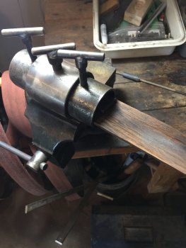

Until I can get one of those fancy sanding knife clamps, this is what I have been using. A wooden screw clamp in my vise (the vise is only temporarily mounted right now).
When I need to sand the top and bottom of the blade I put the wood clamp flat on the vise and clamp it down with a steel c-clamp. So far it works good. What do you guys use?
