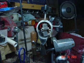

Bruce McLeish
Being a cheapskate , I made mine out of pvc. With it mounted in a panavise, it is infinitely adjustable. cost about free. it ain't purty, but it sure does work well!
