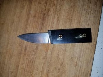

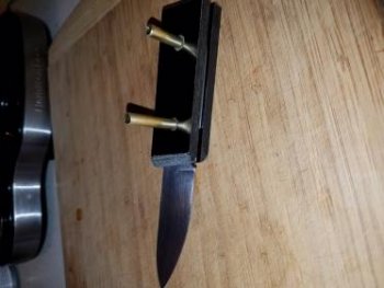

    I was going to wait and get more work done on this First Project but what the heck! Its a small blade about 6" long made from 1/8"x 1"- 01 tool steel, Black Micarta scales. Since taking these pics I have done some more sanding, reshaped the front of the scales to match the plunge line and changed the pins over to 1/4" SS steel. I figure I'm about halfway done? Need to finish sand, blade, harden, temper etc... etc... ok 1/3 done!! I filed all this by hand and think I will make a file jig for my next project to help with the plunge. This has really been a lot of fun and I want to finish it but time is at a premium right now. Any comments from you guys in the know would be helpful. Thanks!!
  2. Dennis Morland
    Dennis Morland KNIFE MAKER
    First welcome to KD. I always like seeing new guys and their first attempts. So keep posting up your progress. It looks like you are off to a very good start.
    Second, being your first knife, I am worried about your outcome. Reading your post, I think you may be mixing up some of the steps. You typed "Need to finish sand, blade, harden, temper etc... ". Don't follow these steps, in that order, you will be vastly disappointed.
    1. Pre-shape and initial bevel. It looks like this may be completed. You do not need to finish sand at this point. Just get it down to 150/220 grit, with no major scratches or flaws. Make sure all of your pin holes are completed while the steel is still in a softened state. Again, it looks like you may already be there.
    2. Heat treat (harden) - After this step your blade will be a mess. Blackened goo everywhere.
    3. Temper - Bring the knife back into a softer state. There is tons of information on heat treat/temper on the internet for o1 tool steel.
    4. Finish sand - Now you can get that blade looking it's very best.
    5. Complete the handle - And then get the handle looking it's very best.
    I simplified the process but you get the point. It is like a recipe, you need to complete it in a specific order . . .
    Good luck!
    DeMo

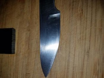

    Got all of the file marks out of the blade and sanded it down to 220. Next the heat treat! I have to do a little more research on this.

    I like to sand my blades to 600 grit before heat treat. It's a matter of preference I suppose, but 220 leaves some fairly deep scratches and they are harder to get out after heat treat than before.
    At any rate, keep up the good work and enjoy!

    Making progress first sanding after Temper. 220grit next stop 400. I've been working on this knife about 1/2 hour each day during my lunch hour. Taking some time but I'm rounding the corner!!

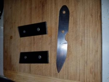

    Finish sanded to 500 grit, glued up the roughed in Black Micarta Scales. Next sanding scales!! No pics this time but I will post some when I take the clamps off. Starting to really look like a knife!!
