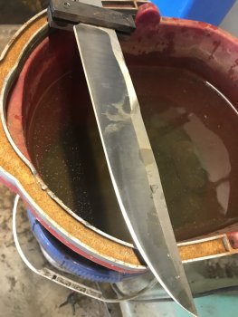

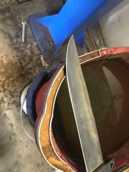

I was able to get a bit of grinding done before the wife came out with the pre-bbq honeydew list.
Edge bevels ground to set set the edge at about 1/16". Starting to establishing a flat.
Working the flats down the blade on both sides trying to keep things even and centered.IMG_6134.JPGIMG_6135.JPG
Working to the spine, I'll work the tip down once I get closer to the lines of the edgeIMG_6141.JPG
Ground through 40 and 60 grit. I'll take it at least to 150 before starting the file work. IMG_6156.JPGIMG_6157.JPG
