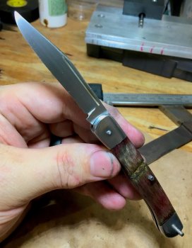

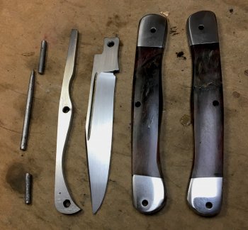

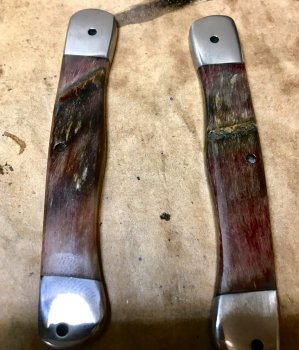

Here is my latest, still a work in progress. It is a Don Robinson “Whittler” design. Blade and spring are AEBL. I made the scales from African Kudu horn.
Still has a bit to go.

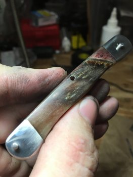

This is my first time using horn. I didn’t take a picture of the back for some reason, but the bolsters are dovetailed to capture the horn should it decide it wants to curl. It is also anchored down with GFlex expoxy.

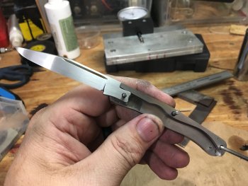

If I may ask, John. How did you do the nail Nick?
I used a Dremel cutoff wheel, chucked up into the drill chuck of my mini-mill. With the blade in the vise I feed the blade into the cutter .005 at a time and run the cross slide left to right, advance .005 and run back the other way, advance .005 and back to the right again- you get the idea. I cut the slot .040 deep by the time it's done. (the blade is .110 thickness)
