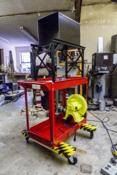

I've attached a pic of my forge stand with the forge on top. Looks humongous but that's the wide-angle lens effect. The center of the forge cavity will be 53" off the concrete floor which is perfect for an old phart who's back isn't crazy about bending over. :D This is a forced air ribbon burner forge, if that makes any difference.

Chris..... I personally believe you would be far better served with a round designed forge....especially if you intend to forge weld down the road. You'll have a far easier time learning, and your welding consistency will be far better. OK, that being said, to your question about castable thickness...... A LEAST 3" thick on any/all castable type refractory, otherwise you're just wasting your time and materials.
I've gone back, read, and re-read your post...... if I'm reading it correctly, your intent is to line with firebrick and then coat with refractory? If so, please don't go that route..... it will only be a few times firing/using it before it all starts to fall apart, then you'll be stomping and cursing it. PLEASE, if you're looking for usability and durability, rethink your design, and your materials. In the end, you're gona do what you want....I'm just trying to save you some time, effort, money...... and a whole truck load of grief.

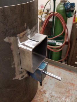

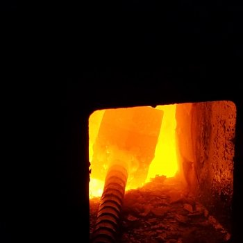

Being that I made my own forge I would have to say 4.25" is a tad on the small side.
To each there own. That would be like me making fun of someone else's motorcycle. The 4.25" is only .25 over the opening on my forge. You have had a lot of good advice. What you do with it is up to you!
