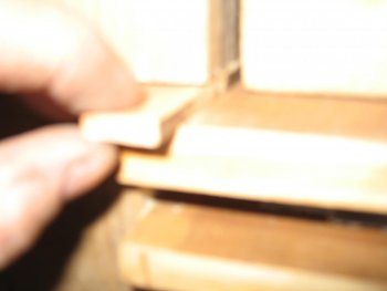

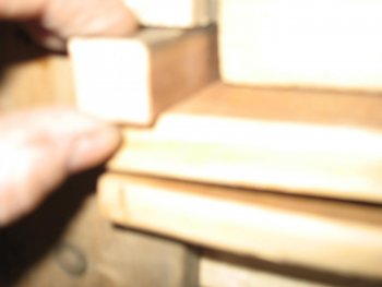

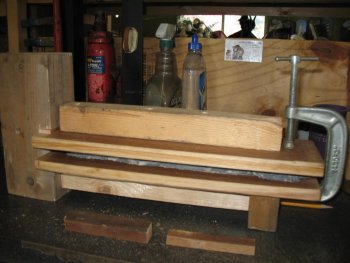

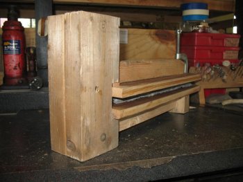

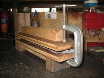

I wanted a press that wouldn't require three hands like my old one that used 4 c-clamps. It was a real pain trying to keep the resin soaked material lined up while holding the boards straight and operating the clamps. This is what I came up with and it works pretty well. The only problem I had was the 1x4 boards wanted to bow a little under hard pressure. I should have used hardwood like oak. I solved the problem by screwing and glueing 2x2s on the 1x4 boards.
Since the one end of the press stays in one position I had to come up with another way to get different thickness micarta. I cut three shims different thickness, 1/4 , 1/2 , and 3/4 to fit in the notch of the press. The pics show how I used the shims. It was easy to make and works great.

I have been thinking of something like this,as you say,it is a real pain trying to keep it all straight.It does't look like you have used it much,but is there anything you would do different?
God bless,Keith
The 1x4s were too flimsy, I should have used hardwood like oak. I just beefed it up with 2x2 instead. I used it one time so far and it worked good. It was a lot easier to manage than 4 c-clamps IMO.
