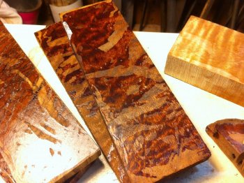

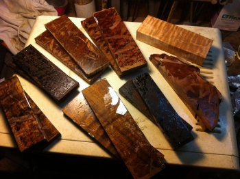

And the 3 sets of scales I ran earlier today:
Padouk:
Lacewood:
Spalted Pecan:
You can see the jar of resin in the pic earlier and how dark it turned from the padouk and lacewood.

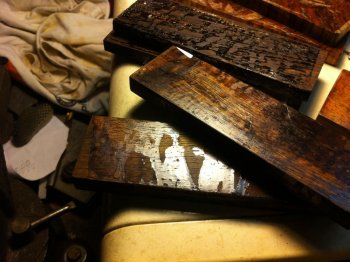

Bodam have you baked yours yet? I did, for about 3 hrs. Not sure if I've done this right. After unwrapping tin foil packs, scales seem real spotty. Some spots look like dry wood, just like it started out, others look shiny.

Yes I baked for about an hour, at around 250ish
I also have bare spots, you can see them in pics.
The resin might just dry in those spots. Because they are fully wet when I bake them.
