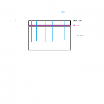

Could I make an anvil by casting some concrete with rebar sticking out the top. Getting some decent flat solid steel, say 5kg's worth and drilling holes for the rebar, welding it to the steel, then grinding it off to get a flat finish? Could add some kind of silicone between the concrete and the steel to reduce the chance of chipping the concrete and noise reduction.
Would that work as a cheap mans anvil with plenty of mass?

Better Idea: Find some steel tube, round or square, that will act as the vertical support (heavier is better) for your anvil surface (thicker is better). Add concrete to the steel tube then weld it up. The concrete will provide weight and mass, stiffen the steel tube and act as a damper for vibrations. However, it would not act as the primary support for the anvil.
Personally, I would not use concrete as the primary support structure for something that's is intentionally designed to be hammer-shocked on a daily basis. Largish steel tube is available anywhere there are people. A simple 2' cutoff should be easy to find. Since the steel tube is now the primary vertical support structure, any homemade concrete mix will work since it only provides stiffness and weight; no need for high-compression load/special mix concrete. Heck, sand would work in that application .

Nice idea... sand would work well if compacted in and then welded shut. Would also reduce vibrations. If I weld some extra plat on top of the square bar to a thickness that sorts out the impacts the weight I need will be sorted by the sand. I could also add hatches so I could empty to the sand if it needs transporting. 1653062820812.png
Buy a cast iron anvil, THEN put a steel plate on top. Weld around the edges. Don't bother buying nickel 55 or nickel 99 electrodes. Nomacast or a similar cast iron electrode is fine. Grind a pretty hefty bevel on the face of the anvil. Preheat the cast to about 400 degrees, weld it, then burry the anvil in dry sand or wrap it in a welding blanket or whatever you can do to keep it from cooling sown to fast. If you have an air hammer with a pointed chisel, you can also go over the welds with that, peening them to help prevent cracking.

So I can get a cheapo anvil. Then weld hardened steel plate on top. Nice..
I've never tried it, but I've been wanting to, just so I know it's possible.
Make sure you use a thick plate.
A better way of doing this might be to weld strips to the face of the anvil. That way you have a solid connection ON the face and don't end up with a hollow spot in the middle of the anvil face.

I was thinking to just buy an anvil, but I dont want a crap one.. I do however like messing about and spending more money than a cheap anvil would cost, to make some ungodly anvil construction footing hybrid to see if it works. (and then have to buy a decent anvil after)
In most places forklift forks must recertified every so often. Forks that do meet criteria are scraped. Sometimes you can get them at little or no cost. I've cut, stacked and welded them together to make decent anvils. I give them to new knife makers.
