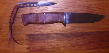

One of our local knifemakers uses a special jig on his 8" Radius Master for his hollow grinds. The custom he made me has a conventional flat grind - the smaller knife lives in the handle of the large - I call it "Mother & Baby"
