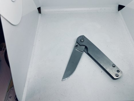

Thanks for your detailed response. I appreciate your input and that you have taken time out of your day to reply to my question. below is a pic of my design in progress. Its not done yet but I thought it may help where my terminology falls short.
69015
I'm open to any and all suggestions. Also as far as the stabilizer goes I say them for sale at ti connector and they license them. I assumed that I was covered there but it couldn't hurt to reach out to hinderer just to be sure. I'm sure he wont be too worried about me.
Thanks again.
