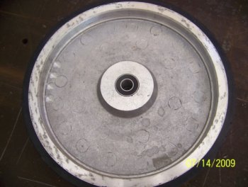

hello, i have done a couple 10" grizz wheels they work great. here's a picture of the one i use.
Go for it.
I've done two myself, you can't beat the price with a stick.
I got one for my bader and one on the home-built.They both run true. There is plenty of meat in the hub for any modifications.
My 10 " Grizz works good on my Burr King. Just had to take some meat off the hub to fit the shaft length.
